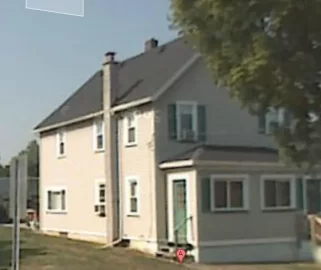

My house is here http://g.co/maps/b4hek
The left corner of my house faces directly north.

Heres my setup
Sierra 8000 Tec wood stove
Heated bulb. Prewarms the chimney and keeps it warm to help prevent downdrafts. The wood stove guy said this would solve my problem $380 bucks later and same issue.
3 feet to 90 degree elbow, 3 feet into wall,
25+ foot chimney
regular cap.
The chimney is not above my roof line. and sits on the east side of the home.
Should i get a special cap? Extend my chimney above the roof?
