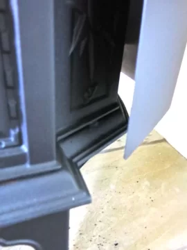

We just got a brand new Jotul Castine and we've never broken in a stove before. We ran the first break-in fire last night as recommended...all went well. This morning we ran the second break in and when the stove reached 300 degrees there was a loud pop and then much hissing from the back of the stove as well as some smoke/steam coming out.
We moved the rear heat shield to find that the seam between the side panel and the bottom panel of the stove had actually spit out hunk of charred black stuff. There was more smoking charred black stuff across about a 1 inch area on the seam. The smoke continued for about 15 minutes then stopped when the stove backed down to 250 or so.
What the heck? Was this a bit of adhesive that burned up and popped off the outside of the stove or is the stove not sealed correctly?
I have photos if anyone wants to see them. Please help!

Also attaching photos.

Is that bubbled paint?
Its hard to say, it could have just brrn excess cement that pooped out, or something could have broken.
300 in 30 mins for the 2nd break in fire doesnt seen too fast to me. What temp did the first fire get to?
I just double checked at the stove and there is no bubbled paint. The lighter color on the seam in the first photo is ash. That's the area that was smoking.

I was referring to the 2nd pic, but looking at other photos i see that is part of the design.
