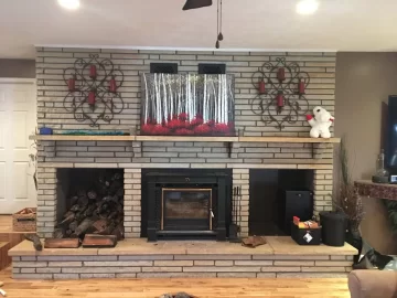

I'm looking for some guidance. I've been visiting this site and these forums for two years now, basically since I moved into my new house with a fireplace. I haven't quite found a situation like mine so here it goes.
Two years ago I moved into a house with a Vermont Castings WinterWarm Large Zero Clearance Fireplace. The stove is 12 years old, the same age as the house. The previous owner(s) have misused this unit and in its current condition it absolutely eats the wood, extremely inefficient. I'm seeing burn times of 2-4 hours using maple & oak with a moisture content of 20% or less. I've replaced various parts and gaskets but things are so warped that a ton of air leaks into the unit and she runs wide open. Therefore, it is getting replaced.
I'm sure I'll need to answer some questions but here is some information in advance.
Budget - Do not currently have one, however, the ultimate goal is to eventually recoop the cost of the stove versus using propane. Propane is very expensive currently.
Stove Location - The current stove is located on the main floor of the house in the living room, the master bedroom is on the opposite wall behind the stove.
Wood Available - I own 2 acres, 1.5 wooded, and I am surrounded by woods available for clearing. The primary wood I have access to is Ash, Oak, Maple, and Cherry.
Climate/Weather - Northern WV (4 Seasons)
Burn Time - I'm looking for 8+ hours.
Room/House Size- The basement is 80% below ground and is 1000 square feet: Bedroom, Bathroom, Utility Room, and Large Living Room. The main floor is 1600 square feet, open concept living room and kitchen, 9 foot ceilings. The master bedroom and bath are on the back side of the fireplace. The 2nd Floor is 1000 square feet with two large bedrooms separated by a bath.
Desired Temperature - 68+ is comfortable for us
Existing Stove - Vermont Castings Winter Warm Large Zero Clearance Fireplace
Existing Liner - 8" SS, total height of 21 feet with 19 feet inside of the house.
Insulation - House is well insulated.
Chimney/Masonry - I do not have one/any.
Right now with the existing fireplace at a 20 degree outside temperature I can heat the main floor to 75ish with the heat radiating upstairs reading around 70+. The house has two furnaces, one in the basement that does the main floor and basement and one for the upstairs. The thermostat for the basement furnace is located on the main floor so when the main floor warms up the furnace doesn't kick on and the basement remains quite cold. (We will get to that later)
I have a pretty unique situation and most places in my area that I have called don't even recognize my fireplace. Therefore, I've had literally no help. A couple places have made me nervous using terminology interchangeable that shouldn't be, I don't want these people installing something in my house that could burn down everything that I've worked hard for.
My goal is to use wood as my primary source of heat, I'm currently using it to heat the main floor, where my wife and I sleep, and the upstairs, upstairs is currently vacant, no kids yet.
My brother currently lives with us while he finishes up his doctorate degree, he is staying in the basement. Right now he is using an electric fireplace in the living room, while he watches tv and does homework, and using an electric oil radiator heater in the bedroom while he sleeps. He is there 10-12 hours a day.
Having said all of this I would love to have something that could heat the main floor with heat radiating to the second floor maintaining a comfortable temperature up there from the radiated heat. I have that now, but with a very inefficient stove.
In replacing this stove I was hoping that I could use the radiant heat two duct system of the Pacific Energy FP30 to pipe heat to his bedroom with one and the other to his living room above the sectional. where he spends most of his time. I currently have a quote of 10k for this exact setup, this is from a dealer about an hour away that I have had dealings with in the past that I feel would do decent work. A major reason for the cost of the project is due to the removal of my current fireplace, we are removing it out the back wall, which will be torn down from my bedroom, as to not disturb the masonry on the front of the fireplace. The system is to tall and cannot be installed from the front without damaging the stone. If this system will not provide adequate heat down stairs, adequate meaning not running two, expensive, electric heaters all the time, then I have no reason to go with the large, expensive stove, that requires a lot of work and demolition.
If the FP30 wont suit my needs I was curious if anyone had experience with the FP16. The FP16 is small enough that it can be tipped over and slid into my existing opening without any demolition, I have a quote on this install at 6500. Both installs include the stove installed, liner, framing, ductwork(fp30 only) etc,. Will the FP16 Heat the 1600 sqft. on the main floor and radiate good heat upstairs like my existing unit? Size wise, is the FP16 the best unit I can get for as far as ZC goes?
An acquaintance suggested I pull the old stove out, line the opening with brick/stone, and put a free standing stove in. Is this even possible or recommended over the ZC?
I'm just trying to figure out what my options are. Logically speaking I highly doubt that the radiated heat piped through duct-work downstairs will be enough heat for that large of an area. However, I thought I'd ask to see if anyone could attest to how much heat would be produced.
So if the FP30 is out, what would you guys recommend? I currently have propane heat, a coworker recommend I put a propane fireplace downstairs to heat the area when needed and use the smaller fireplace upstairs to heat the main floor and upstairs.
10k and 6k are alot of money and with my specific situation I can't get any good help/recommendations and ITS DRIVING ME NUTS.
Thanks in advance to everyone who responds!

Backwall1: The wall in the bedroom that will be demolished to insert the larger FP30.
Underneath1,2,&3: Area underneath the hearth. The block wall in this area is one of the walls to the downstairs bedroom, the ductwork can literally be run straight down. This area underneath the hearth is 10% underground with a double door that opens to the back yard, easy access for an OAK if needed.
WinterWarmSpecs: Current specs on my existing stove.
