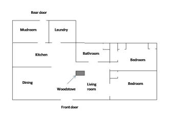

We are going to remove one bedroom from the middle of the house and then divide up our other super large bedroom into two regular sized bedrooms. This will actually completely open up our whole house. We then plan to put a new woodstove in pretty much the center of the house.

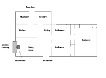

I'm going to try to attach two images to this post. The first is the existing layout which has the stove all the way on one side of the house which keeps the other end of the house 15-20 degrees cooler than the stove end.
The second image is of the new proposed layout.
The interior square footage of our house is about 1200 sq. ft. The main living areas are about 1000 sq. ft. and the mudroom and laundry room add another 200 sq. ft.

So, I guess what I'm asking is, check out my proposed new home layout image and let me know which models of Hearthstone, Jotul, and Woodstock stoves would be most appropriate.

oh ok, so the image on the left is my existing layout, the image on the right is my proposed modification
