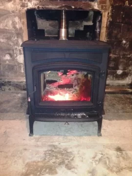

This is the place (rather unsightly right now) that our new unit would go:
![Help me choose - Jotul F55 free stander or Pacific Energy Summit insert Help me choose - Jotul F55 free stander or Pacific Energy Summit insert](https://www.hearth.com/talk/data/attachments/145/145186-b089e6352116f480d75a093377f5bcb7.jpg)
I know that some of the insulation and wood studs would need to be pulled out to give proper clearances. The plan is for us to finish the basement, so that ugly brown hearth has got to go too. The basement walls are insulated (as you can see), but there is no insulation in the floor between the main level and basement. I don't have delusions here that all the heat will rise to the main level, but I'm hoping it will at least make the main floor (hardwood cherry) feel warmer under foot.
