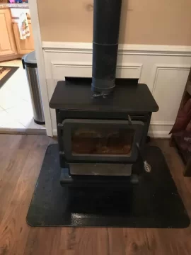

I found this stove for sale locally, and I'm trying to identify it to see if it will fit my needs. The owner does not have an identification plate or model number.

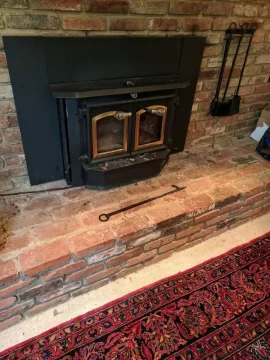

My current insert
Pros:
Looks good
Has two decent sized windows where you can see the fire
Takes up very little space
Takes nice big pieces of wood
Cons:
Eats wood at a pretty fast rate
The fan is loud
Is not efficient
A replacement stove
Pros:
Would fit on the brick in front of the fireplace without me having to do demo or take up extra floor space
Would take medium to large pieces as I already have wood cut for the insert
Have a nice window I can see the fire through
Would have a single door that opens to the left like the one for sale
Be efficient. Have a secondary gas burn chamber
Not cost a ton of money. Used is perfectly fine.
Wouldn't need a loud fan
Cons:
Would have to sit out from the fireplace to do any good, taking up extra space
Area would have to be setup to comply to code/not set my house afire (removal of carpet, placement of stone tile)
Might cost more than I think
General info
The brick ledge in front of the current fireplace is 14 inches tall, and 23 inches deep. The actual fireplace hole is 29 inches high (for the purpose of getting the pipe back there)
I'm aware and prepared to pull up the carpets and put down fire proof tile
When I put the insert in, I had a company clean the flue and install a flexible pipe that goes up the chimney. It is to code as far as I know
I have a friend who has a stove that looks like the one for sale. It has an exhaust control and another lever to control a secondary gas burn chamber. I've spent a fair amount of time over there and it seems to be drastically more efficient than mine.
My two questions are:
1. What is the model of that stove for sale?
2. Do you think I can place the stove on the brick in front of the fireplace or will I have to demo/place it on the floor in front of the brick?
