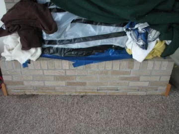

I'm realizing that I need to add on to my hearth area. I've been reading around the site and feel confident I can do this on my own.
I need to add about 10" to meet the minimum 18". I have been playing with the idea of tile or stone.(and if I went with stone can you get custom things made?) . I have found some kind of new tile @ Menards that says it can be put down over plywood. The area that I want to protect is in front of the stove. There is old vinyl under the carpet. I have read about the durarock but I'm asking if this is really needed or can I just get some stone from the landscaping company..cut the carpet..use liquid nails/thinset and be done? I think I'm going to try to trim/1/4 round around what ever I do ...so I'm just trying to brainstorm right now. Yes, I realize I could build a steel frame/durarock-etc and build higher...just trying to get something down now...Before I run all over creation looking..I thought I'd pick your brains. BTW hearth is ~66 3/4 wide.
Now if you are wondering why my $4000 hearthstone is still covered up? I'm still getting a lot of cold air coming from around the stove. I've had the installers out (they only used insulation-no block off) and they say all this cold air is normal. The room gets in the 50's if it's not covered. I'm having them come back out and install a blanket and a blockoff plate. I tried to keep the business local (because we know them).

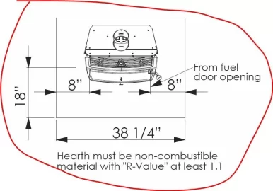

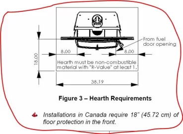

After reviewing the manual/schematic I am really confused.. 1 pic makes it look like I only need the 9 or 10" that I already have and the other pic makes it look like I need 18... Any experts out there.....?

The diagrams show that your hearth must extend 18" to the front measured from the fuel door opening (not the ash lip), and that in width, it needs to be 16" wider than the width of the fuel door opening.
The "non-combustible" and "R 1.1" requirements would not apply to anything that you do in excess of the size above.
Logically, with the height of your hearth, your extension would likely be in the "shadow" of the brick hearth, and the specs might seem like overkill, but, if you do have a fire, you certainly don't want to give an insurance adjuster any excuses to deny your claim.

You could put the mineral board down, then the Durock, then nail carpet strips around the edge to hold the carpet tight, then let your stone hang over the edge of the Durock about 1" or so to conceal the edge of the carpet. This makes for a nice neat transition.
Yeah, you can just build a wooden framework that is just shorter than your existing brickwork and then cover it with a layer of plywood and then a layer of durock and then tile on top of the durock - and plan it so that it works out to be the same height when its all completed.
