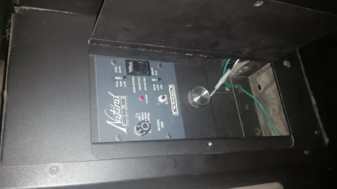

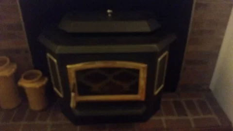

I recently bought a house and there's a (earth stove) pellet stove already installed. I have never used one of these and really need someone to walk me through how this stove works. I have attached picture of the stove that I have. Any help is greatly appreciated!

first before messing with it i would try to find a manual for it , is that a fuseholder or probe below the knob there 2nd pic
It's a fuse. I actually have a manual but to be honest is not very helpful. It tells me how to do things step by step BUT uses the terms such as "the hopper" and "firepot" as if I should know what those are. It gives no description as to what those terms mean.

In your first picture, see the gold knob at the top? That is the door to your hopper (where you pour the pellets in). You may have to twist it before the door will open (maybe just have to pull hard though). I suggest that when you are ready to try your hand, you only put in a couple of cups of pellets (maybe a mixing bowl full). That way if things aren't quite kosher, there isn't much to burn. Take a look at this simple picture http://img.bhs4.com/fd/9/fd96cf236afd081266b64e385bb61d905c5658a5_large.jpg - it isn't your stove but should give you a general idea of some of the stove terminology.
If you open the door in front, the firepot will be inside. I am unfamiliar with your stove, but I would assume it is centered to the door and may even have some pellets left there and should look something like this: https://upload.wikimedia.org/wikipedia/commons/f/f2/Pellet_Stove_burn_pot.jpg
Once you look at the diagram and familiarize yourself with the terminology, try looking at the manual again. Hope this helps and good luck!

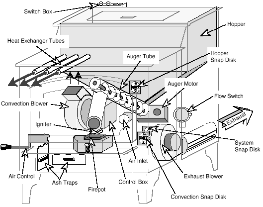

Here is a quick picture labeling the various Pellet stove parts.
View is from front of stove.
Help! How do I get this going?
Basically there are two air movement systems in the stove.
Combustion (the Fuel and fire side) and Convection (The turn the cold air into warm air)
Basically fuel (Wood Pellets) are stored in the hopper. At the bottom of the hopper is a screw auger that "lifts" the fuel up so that it can fall into the fire box where it feeds a burning fire. Exhaust gasses are circulated past some heat exchanger tubes and are sucked out to the "Venting" pipe to outside via an exhaust blower. There are some electronic controls to keep all of this continuing safely and efficiently.
The Convection Blower takes "Colder" room air and pumps it thru the inside of the heat exchanger tubes and makes it hot(er). Dispersing it into your living space.
Most modern stoves use an electric igniter to start the initial fire but they can also be started manually using starting gel or a propane torch.
Newer stoves control almost all aspects of the burn cycle regulating blower speeds, fuel feed rates, and even are run on thermostats. Older stoves rely on temperature snap disks and manual controls. Nothing wrong with either its just a matter of convenience. More "bells and whistles"
Hope that gets you started.
