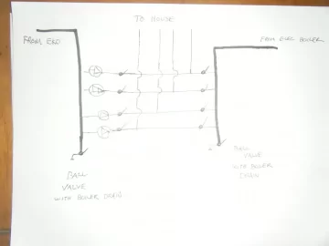

Thanks guys for the input. I attached a crude sketch of the zone piping where the EKO and electric boiler connect to the zone piping. I'm not even sure if changes anything.

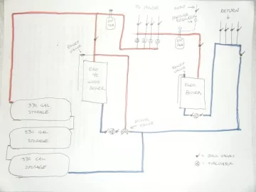

Right now the electric boiler is the only thing up and running. My tanks are in place and I am starting to connect all of the copper to the tanks and working my way to the EKO from the storage.
RobC, You asked about the ability to move my boilers and such. Unfortunately, that can't happen. My electric boiler is existing, and mounted on the wall. The EKO is directly to the left and replaced an old woodburner. It is as close as I could get it to the chimney. To the left of the EKO are the storage tanks. These are against a wall, and seperated from the EKO by a doorway.

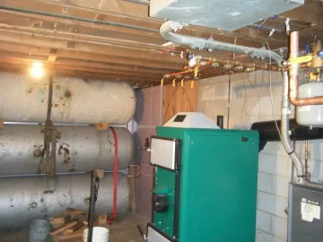

Here is a pic that shows my setup. The grey box on the lower right corner is my electric boiler.

Now I understand the ladder. You're going to shut off all of the valves to the electric side.

I said that the locations can be where you planned but change the way their are piped. Anyway....
If you have already plumbed what you drew on the last post and you have the electric boiler running so that plumbing is complete. You need to have at least a check valve or a circulator with check valve on the electric side. ( which Benjamin has pointed out )
With a lay out like my drawing your zones are pulling evenly. ( There are many things missing from my drawing ) I just trying to point out that the "ladder" area is concerning.

Yikes, thoses tanks look like a disaster in the making. Is that the only thing holding them up? You need to get those better secured before you fill them or we will be having a memorial sevice for you on the fourm.
Henfriut, Good observation, that had been a topic of conversation when the picture was posted a few weeks back. Hopefully that has been reinforced.
Yeah guys, the tanks are fine. Securing them is the only thing that I have engineered correctly. Couple of treated 4x4s, some all-thread with washers and nuts and a few concrete anchors. No sense in fretting about them until I'm actually able to fill them with water. lol!

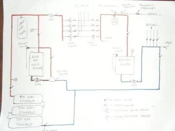

OK guys, I posted a new sketch. I incorporated everything that people have suggested. I am still curious if my "ladder" design will work now with check valves. I don't want to shut off the electric boiler with ball valves because I want the luxury of the electric boiler to function when I'm away or out of firewood.
I put alot of detail in the sketch this time. My next post I will post a sketch of what is already installed.
Rob C, I hadn't given alot of thought to an expansion tank until you pointed it out. I added it to my sketch. Do you have recommendations as to what kind, what size and where to place it.

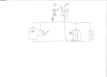

As I mentioned earlier, I'm leaning towards Zone Valves instead of circulators. I noticed in one of the stickies that the Taco EBV only uses electricity when it opens or closes. Anyone know anything about these? Recommendations?
Thanks Rob, Benjamin, Taxadermist and everyone else for not abandoning me just yet!

Your storage is the same as mine. Mark from Ahona provided me the following when installing the unit I purchased from him:
Mark, If we calc 1050 gallons at 55degrees to 200 degrees the expansion factor is .0348 so 1050x .0348 is 36.54 gallons expanded volume. You take 36.54 divided by an acceptance factor of 0.408 which is a system pressure of 10 psi you get a total tank volume ot 89.55 gallons, The SX 160 is rated at 46 gallons of expansion and a total volume at 86 gallons so we are border line even at that.
Mark
You can plumb expansiOn tanks in parallel if two smaller unit work for you (you might find two smaller ones locally available while the SX 160 is probably special order).
Thanks Hunder, Thats a big help. Due to lack of room I want to put the smallest one in that I can get away with. Should I put another air eliminator in too, like I have on the electric side?
You locate the air eliminator for the EKO as close to the hottest & highest outlet spot as possible the hotter the water the easier the fluid releases air.
Expansion tank. If you get sticker shock from buying a expansion tank you can build one from a 100 gallon propane tank if you can get one used. Make sure it's a 100 gallon not a 100 pound. Any tanks are going to need floor space. There are some threads on DIY tanks.
Zone valves work well. If for some reason you are not getting enough heat out put to handle multiple zones you can add a Taco Zone Priority Switch.
One use for the EBV is for power loss dump zone. Powered transformer holds the EBV closed, when the power goes out EBV opens and you get your gravity dump.
Thanks for the info on the expansion tanks. If anyone can assure me that the SX160V (86 gal.) will be sufficient, I will probably go that route. Pex Supply has them for under $500 including shipping. It will probably cost me every bit of that to hunt down a propane tank, drive and get it and make modifications.
