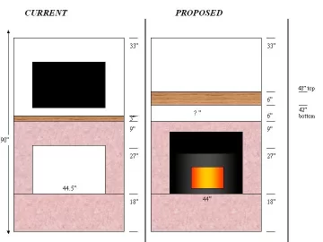

2. AND THE BIG ONE.. I have a large hearth on the fireplace, 18" high. Leaves a current 36" from hearth to the bottom of my 3" mantle.. The Jotul manual says a minimum of 51 3/4" or 42" from bottom(with "Mantel Heat Shield") is required for the stove. Top of mantel with heat shield should be 48"
(broken link removed to http://www.yankeefireplace.com/uploads/products/documents/jotul_rockland_insert.pdf)
So this means I have to raise the mantle 12" up to top, and make it (a new one) 6" .. SEE DIAGRAM.. leaves me wwith 6" of my current wood panel. I could come up with a 12" high mantel as well I suppose..
