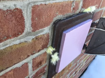

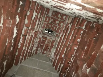

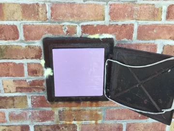

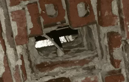

I have a full brick chimney with an ash clean out in the back of the house. I took picture inside the cleanout and as you can see from the picture that I zoomed in on the romex power cord and the black gas line is visible - I do not think I should be seeing that!
I also am not sure if or where the fireplace is sealed from the top of the insert to the top of the chimney.

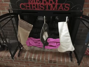

any help would be appreciated as right now I have a towel in front of the fireplace to attempt to block the air
![Help fix my draft! Help fix my draft!](https://www.hearth.com/talk/data/attachments/219/219159-58a1194c3dca4bc42647456882631509.jpg)
The stockings will actually sway a lil if I remove the towel.
