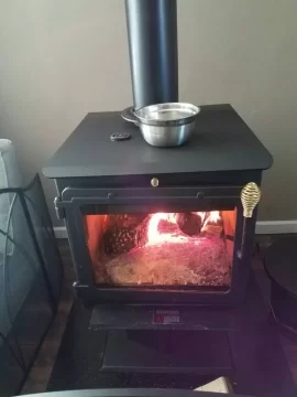

Wayne.nestor

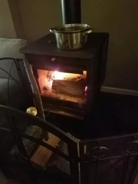

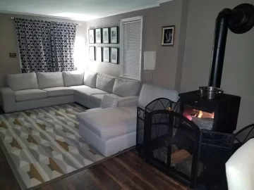

Safety Note:
Is that piece of furniture getting a little hot that close to the stove?
Help finding new stove
Wayne.nestor
Safety Note:
No. It is only barely warm to The touch when a 500 degree fire is going. Most of the heat comes from the top and front. There's a metal shield on the sides that overlays the box. The shield is for the blower so it can maximize the warm air between the shield and the fire box. The couch is the minimum recommended for combustibles as well. The spot gets very warm sitting there but it's not scorching. I'd like to move it more but there isn't any room to lol.
Oh and I also think that metal gate I have wrapping around the wood stove is deflecting some of the heat as alwell. Like I said, the material is warm to the touch but not hot. It's similar to pulling a fresh load of laundry from my gas dryer with it on medium heat ( for reference )
