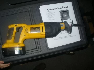

righty tighty - lefty loosy!
Wanna use this??
Eric

My husband has one of those. Great idea! I have cut my fingers and have a blister trying to get this cap off. I'm done with it. I was only going to get about a teaspoon full of ash anyway.
