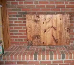

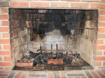

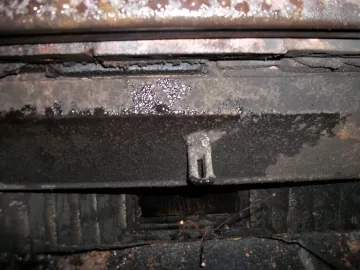

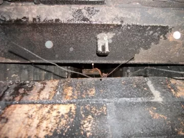

Here are the dimensions and a few pics up the chimney to help you help me. My fireplace is...
H 39 inches
W 29 inches
But the firebrick on the rear of it tapers
At the bottom it measures 23 inches deep
At the middle it measures 21 deep
At the top it measures 18 deep
I really want a glass door to see the fire since its in the living room. I want a blower, but would add an ecofan if thats what it took to distribute the heat throughout the 3 bedroom house. It would be blowing toward the hallway where the rooms are btw. I just measured our upstairs living are and not including closets and the bathroom I came up with 944 sf. So its safe to say 1000 sf right?
