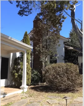

We'd like to switch to heating home with wood (instead of pricey propane). Our house is roughly 2800 s.ft. with a chimney running up the side of an external wall (about 25' high). It's a single layer thick masonry chimney--unlined. It's quite spacious inside and was being used to vent a propane fireplace insert, which I've since removed. This fireplace is located roughly toward the center of our house, although our home has an unusual floor plan, having been added onto twice in its 100 year history. Note: the area around the chimney cap is clear of limbs and branches...just looks like it in the picture.

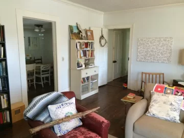

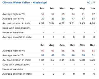

Given that we live in northern Mississippi, our winters are not nearly so brutal as those further north (see below). That said, we'll likely be running the stove/insert almost constantly for 3 or 4 months per year.

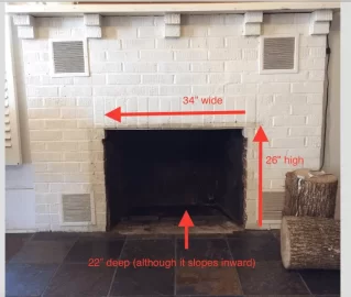

Here is an image of the fireplace with dimensions.

As you can see, this fireplace is relatively small. My original plan was to push a top venting stove into the firebox, but the fact that it is only 26" tall is particularly frustrating since most stove ares 29+ inches. We were particularly interested in the Englander 30-NCH, but it runs 30." I've read of folks cutting legs down to accomplish this, but that seems like an awful lot to remove. It should also be noted that the floors under the ceramic tile are wood. I'm not sure what kind of board these tiles sit on.

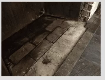

Here's a closer image of the fireplace. Note the propane valve and the moisture collecting toward the back of the hearth. I think the moisture is due to a leaking chimney cap...but not sure. The floor of the firebox is a combination of brick and what looks like cement...but not sure (again).

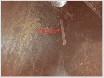

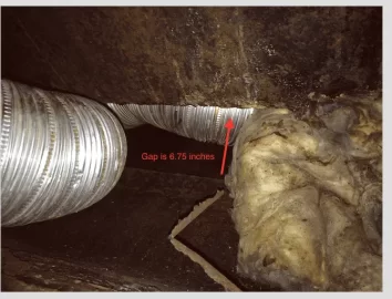

Here are some more images from the inside:
