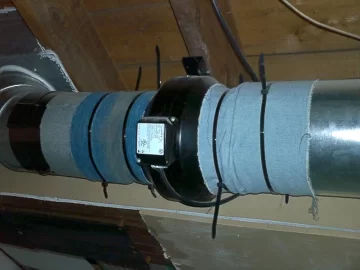

If I were you, I'd put in a large wood stove (Summit comes to mind), and install in-line fans like I have pictured here, and insulated ducts under the floor, bringing air FROM the colder rooms, and having them exit into the dining room right behind the stove. Doing this will draw the heated air into the rooms where needed, and keep the dining room from getting too hot. You might then cut return vents into the walls and cover them with decorative grilles so they look nice.
