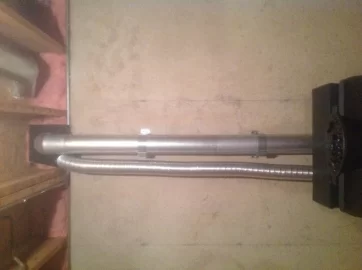

thanks, reallyte, I figured that would come. With my lack of knowledge and proper terminology, would a picture help explain this?

Very green is very accurate. :) I did read the manual today, but felt like I was reading a foreign language! Sorry that I couldn't get it rotated, but let's start with this.

I would try hard to get a few bags of another brand, clean the stove and burn the other product, this will rule in/out your existing pellets but it does seem like incomplete combustion. Rule out the easy thing first - the pellets.
Maybe a pic or two of the flame you are running. that might help with diagnosing if there are air flow issues.
You say they came out and cleaned it at the start of the season. Did they clean the full length of that pipe? did you see them actually do it?
A picture of the terminating pipe helps too.

My eyes might be off here, but wouldn't you want 4" pipe for something that long? Maybe the stove is exceeding the EVL.
Somersets are good pellets and I have not experienced any tar like junk. Not saying you couldn't have gotten a bad batch though. Need a pic of the flame burning and your outside vent too. I wonder how well some of these dealers and such actually clean the stoves. How long did your clean take?
A couple of additional pictures one from the outside of the house please and the other showing the area behind the stove.
