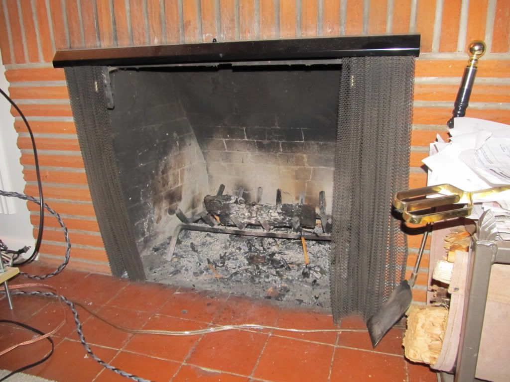

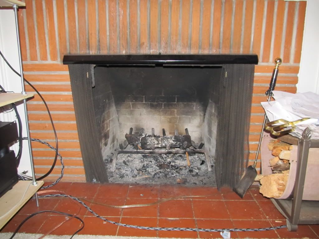

My opening is 32-1/4" wide, 26" tall, and 25" deep. As far as the flue, it's the metal thing that opens, it's 32" by 6". My chimney opening at the roof is 15"x 6-1/2". I don't believe it's a prebuilt,it's original to the house which was built in the late 20's or early 30's. It's all brick and mortar, how would I know for sure? If I could get away with not running a pipe all the way up the chimney I would like to. I thought I read that if you sealed off the flue from the opening there wouldn't be a problem. Either way the budget for the stove is around six, any extras I'll pay for I guess. I'll see if I can go for that liberty. I'll give them a call.

You have a Masonry Fireplace. If its all brick and mortar.
3 things.
1.) with a 15" x 6.5" Tile chimney, I think you will have to use a Liner. I dont own an insert, but I have read almost every Thread on this Forum. And that is a large opening, that will not draft well at all.
2.) With a 26" hieght on your fireplace. You will more than likely need a Rear vent only stove. If you go the Freestanding route.
3.) You will also need a hearth extension if you have get a freestanding.
Cheap liner can be had for $600 shipped. A memeber just installed an Equinox and got his liner for under $600 if I remember correct.
Does it have to be up the Fireplace??? Another member has Thread about Supervent being so cheap... It may cost about the same.. $500-$700 with the Through the wall/Ceiling kit. But if you used Single wall inside and only needed 2 sections of Class A it could be pretty cheap. Also search Craiglist. Lots of Chimney sections go on sale.

I'll get pics posted, I also have another local option. It's a Jotul for $120?

P.S. don't mind the audio wires, they'll be moved.

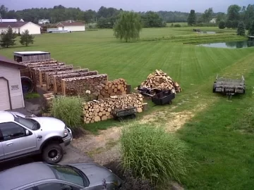

Agreed on the Wood. I will leave mine outside for a year or 2. Then move it into the little Shed. It holds a little over 3 Cord. Wood will be fine outside. Nice to cover the year you use it, so you dont have to worry about Snow coming in the house and sitting on your splits.
