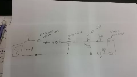

Well here goes. I'm installing my Garn and right now I'm working on the floor heat in my pole barn(which is currently were my family is living during our remodel).
I've read a ton of stuff over the last few years but sometimes things get fuzzy with data overload. So I'm asking you guys for some help & confirmation on my system. Nothing on this side of the plate exchanger is installed yet. I'm hoping to be heating by Saturday, Sunday at the latest.
A few questions.
1. In my diagram is this the proper layout for all the parts in the system?
2.Do I need to move anything? Before or after the pump?
3. Can I put the relief vavle on top of my expansion tank using a cross?
4. I bought just a relief value, no temperature, is that ok?
5. Should the air scoop be the highest point in the loop?
Edit: 6. Should I have a high point for a spigot to bleed air when I'm starting up for thr first time?
I'm sure I missed something, hoping nothing to big.
Thanks guys
A few questions.
Thanks guys
