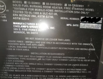

Hello! I wanted to add this - a picture of the plate located on the stove. Except for my blocking out the serial number, it is exactly what you see.
[Hearth.com] Heating flue of Englander Madison wood stove.
Sounds fishy to me...if the stove is not approved for use in the US any longer then they should issue a recall...can't see how insurance co. could deny an claim if it was approved when it was bought, and nobody from SBI has contacted you in any official capacity about it...and not sure some techline person just telling you that even qualifies as "notification"...unless maybe they email you a copy or something.
I do know that SBI bought Englander out, but SBI usually handles their business better than this...
