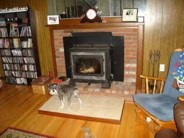

I've got something similar, and the Hearthstone Homestead worked great for me: no fan noise, heats the whole of my upstairs (1,100 sq. ft), looks pretty, and runs like a top. Currently 72* inside, 23 outside. Went the whole day with 6 pieces of oak.
Manual with dimensions here: http://www.hearthstonestoves.com/wood-stoves/stove-details?product_id=19
PM me if you'd like more info/pics.

  • [Hearth.com] Hearthstove vs insert for 1100 sq ft house
