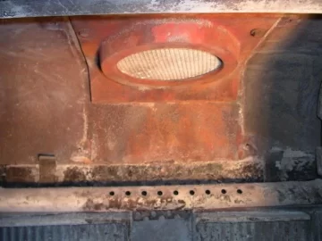

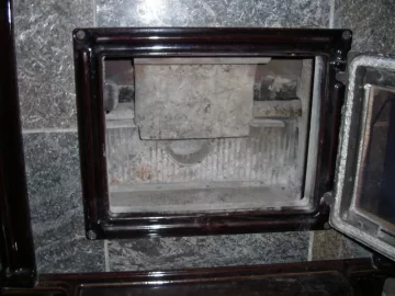

finally got around to snapping some pics. only had room here for two. the pic inside the stove shows the cat combustor sitting atop the holder after I reinstalled it. the pic outside shows the combustor assembly baffle, which covers the other two pieces, and really cuts down on the firebox size! had a hard time getting that braided rope gasket back in, and I'm not sure it's quite where it originally was, so, some efficiency may be lost. running the stove today... nice and toasty!! :coolsmile:
