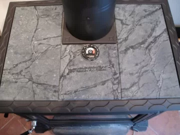

I've had my Hearthstone Heritage for two weeks--photos attached. We found a stove that has a larger and more interesting pattern in the soapstone than others we've seen.
