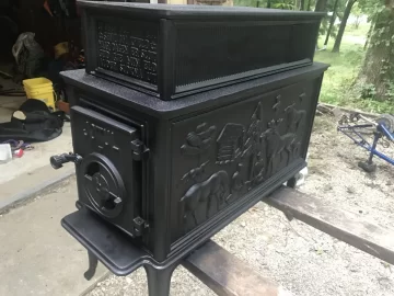

Your 118 is easy to recognize if it’s truly a Jotul. Norwegian writing above the door, JOTUL on the door, lumber jack scene on the side. Here’s one I’m currently fixin up.

Webby - Thanks for posting that pic! That was a trip down memory lane for me. A friend of mine had one and it reminded me of hanging out with him back in the day.
Always loved the scene on the side - the stove heated his home and was a piece of art.
