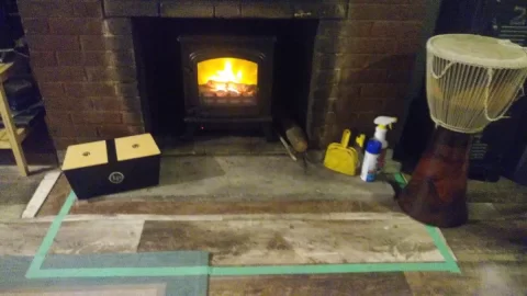

I have the next couple of weeks to reconstruct my hearth before I have a Lopi 1750i installed. I'm not exactly sure the best way to go about it.
Right now, there is standard sized firebrick mortared inside the metal firebox. Then it steps down to what was left after i busted out a broken hearth from the 40's... Leaving behind the structural hearth cement slab... This extends out 9" from the outside Brick wall of fireplace. The 1750i will extend out to that point. The green tape represents how far out I will need to go with my non combustible material, another 16 inches. The greatest depth of the front half of house is 11 1/2 ft, so more narrow than this where fireplace is. For this reason i am hoping to make that 16inch extension as close to flush with the floor as i can. I got one of those multipurpose tools to cut that space down a couple layers.
Big question: I either need to build up the cement slab area to reach the height of the firebrick, or i need to remove the firebrick and resurface the whole slab. My style is rustic industrial... So I'm not looking for anything super fancy, but rather more earthy/artsy.
I thought about slate tiles... Or picking from piles of cast away stone at my local stone company (definitely on a budget) for the upper hearth... And then something thinner for the remaining 16inch extension... Totally open to suggestions!
In your experience, am i better off with a smooth surface (tile) that is easier to sweep (unlike the uneven surface of slate or raw stone)? Or doesn't it really matter? Ever see sheet metal used on floor? What would you use if you were starting over?
Then with the brick chimney... That was the best i could clean it after many cleaning tactics... If i decide not to put the surround on... Then maybe I'll paint it to coordinate with the other materials I choose.
I would love your thoughts! Thanks!
