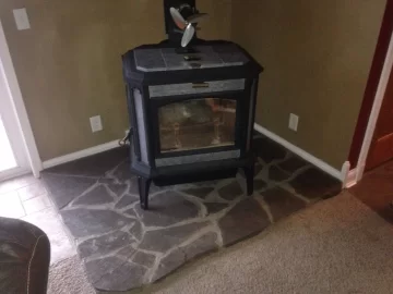

Before........
[Hearth.com] Hearth rebuild question?????

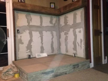

Current...

You will never see the 1" gap at the top under the mantel. Paint the top 2" of the Durock wall flat black and it will become a shadow line under the mantel. The bottom should have a 1" gap above the hearth to permit good airflow. One solution would be to take the stone down to the hearth at the studs and leave a 1" x 12" vent slot in between each stud.
How thick will the stone veneer be on this wall and how close will the stove corners be to the walls?
Veneer is from about 1/2" to 1 1/4" probably....I previously had 16" to corners. I'm hoping to tighten that up a bit
What is on the other side of these walls? Could you install some vent grilles on the backside walls at the bottom to admit ventilation air?

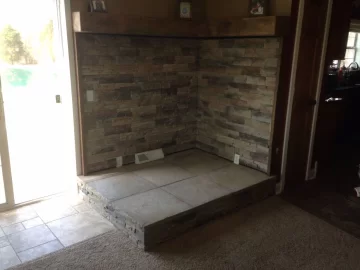

Finished product.....with 1" air space, Duroc and the stone veneer with gaps top and bottom! Should keep the wall much cooler! Total investment of about $500 total from start to finish, not bad
  • [Hearth.com] Hearth rebuild question?????
Back side of one wall is an exterior wall and the other one is open in a chase on the other side...
That looks great. I'm in the process of finising my hearth.
What did you use for spacers on the wall
Snap off 3" by sheet length or width strips from the cement board. Double them up and you have non combustible 1" spacers.

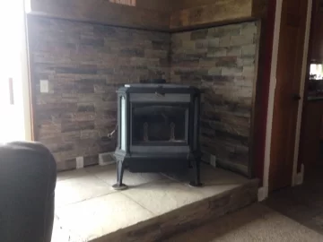

Got the progress back on the hearth! The sliders are still under the legs and no pipe but she's back home!
Nice. It's much more of a focal point for the room now.
