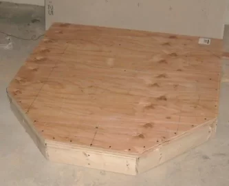

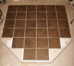

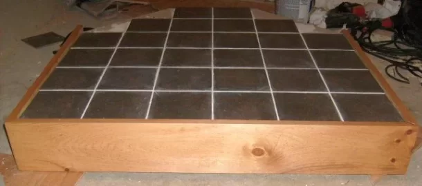

Here is what I threw together for about $125 in materials.
Of course, my time does not count!
Before cutting the 2 back corners, the pad was 36"X36"
I used the specs from the brochure which showed the required
pad extension beyond each side of the stove. 6" front and sides and 1"-2" out back.
I had to make mine 5.5" tall so as to clear the hot water baseboard.
2X4's for the frame (on their side)
2 layers of 1/2" plywood
2 layers of 1/4" cement board
Layer of 6"x6" tile.
I had never worked with tile/grout before.
If you are a bit of a handyman it is doable!
Hope this helps!

$480 is pretty steep. My neighbor paid $120 for a plain jane black pad.
lessoil - Thanks for the pics. The old saying a picture is worth a thousand words. This is true. Do you have a finshed view of it installed?
stejus,
We are waiting for a call from the dealer as to what the install date will be.
I will post pictures as soon as that happens.
FYI,
I bought the cement board, tile, tools and grout at Home Depot.
The rest I picked up at a local store. The trim is plain old pine 1"x 6"
stained with Minwax.

lessoil said:
...FYI, I bought the cement board, tile, tools and grout at Home Depot.
I think it came out real nice....especially like the simple edging w/ the Minwax....great job, nice pics too! :coolsmile:
