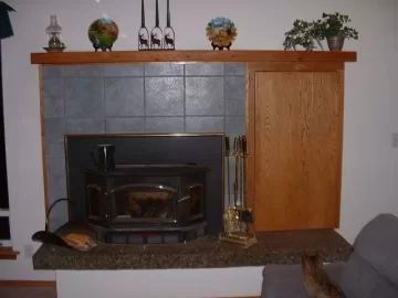

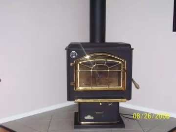

I have been thinking lately about doing something to the walls behind my stove to make it look better then just plain drywall. The stove is installed in the corner on a hearth pad; I have plenty of clearance from the stove to the wall to add brick or fake brick any idea’s?. Does Home Depot or other stores sell decorative fake brick that can be installed easily?.
Thanks for suggestions.

You've got a nice start, I would continue up with tile or perhaps stone on the wall to a bit over the top of the stove instead of brick (especially not fake brick). It would look a lot classier.
I don't know about HD, but many places carry Cultured Stone or similar product, they aren't too hard to install. I think tile, either ceramic or slate would also look nice, it's easier to install than CS, and less expensive.
What is the "style" of the house? We were going with more of a rustic look and choose the cultured stone. In a more contemporary place I think tile "fits" better.

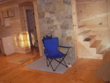

I have always liked the cultured stone look.
Ed

Very clean looking the way it is.... but I would probably go with the tile. Me... I'd try to match what is already there if I could. I'm no good at picking out different colors that end up looking good together.

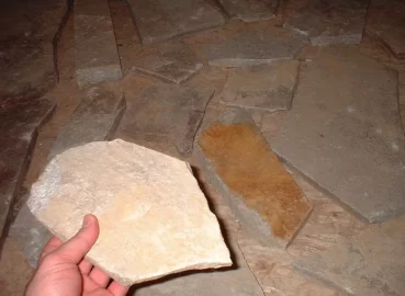

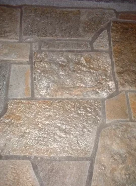

We used something called Sunset gold, I really liked the rust/grey color and Mica speckles.
Ed

Hi Greg , sorry about the late reply. After checking my records I paid $7.25/sq ft for the cultured stone that makes up the wall behind my stove and hearth.
I managed to take some photos of the stove in action which I will be posting to the photo directory if interested, unfortunatly the camera that I used to snap the photos is the same camera that I used to take pictures of me insulating the underfloor and did not realize that the lens was contaminated heavily with fiberglass. (lots of spots)
Ed

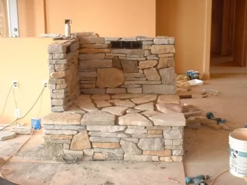

Greg, here's my new hearth with cultured stone, it needs the cap on the wall yet, and of course the stove, but thats another thread. You might want to check out the cultured stone web site, all kinds of cool ideas. Installation is kind of fun, sort of a big jig saw puzzle, with mud!

Well Done! that looks fantastic and you are correct about it being a big jig saw puzzle, what helped me visualize was laying it out on the floor first. Question how will your stove be positioned on the hearth?

The stove will be facing outward (towards you) as seen in that pic, the area left of the stove wall is where I'll be setting the TV and building some sort of stand and entertainment center. I haven't quite figured out what kind or size of TV is going there yet, kind of up in the air what I'll build. I'd like to do some sort of log or cedar detail there, to match some other cedar in the great room, but the cedar is lousy from a structural standpoint. That will be one of my winter projects, I have plenty to do to keep busy. We'll be moving in as soon as I get one bathroom finished, the kitchen cabinets/countertop/plumbing done, there will be plenty of flooring and detail work to keep me out of trouble and broke for some time... Gotta get the stove before I spend all my money on other stuff!
Greg, your installation would be a fairly easy and affordable one with cultured stone, you don't have any outside corners to deal with. Any chance you would have enough clearance to "cap" the stone with a half log? I've seen this before and it really looks nice, if it fits with your style of home. I didn't have the clearance to combustables to get away with that with mine, will have to do cultured stone for the cap as well.

Bri - I should have plenty of clearance to combustables, my stove only needs 2 inches (Corner install) clearance to the wall, and a few months ago I installed a "TEE" to make it easy to clean the class A, Doing this pushed the stove out 9 inches total from the wall. So I still have 7 inches of space that can be used and still maintain the 2 inch clearance that I need.
