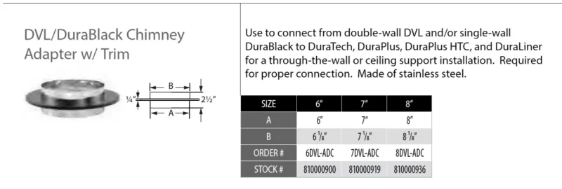

The chimney needs a support brace at the 5' point. The DuraVent installation guide shows how and the proper angles. There is a transition adapter that you need to have to connect the DVL to the support box.

There is a transition adapter pictured on the box to the chimney kit but mine didn't have the ring. That is ok,
