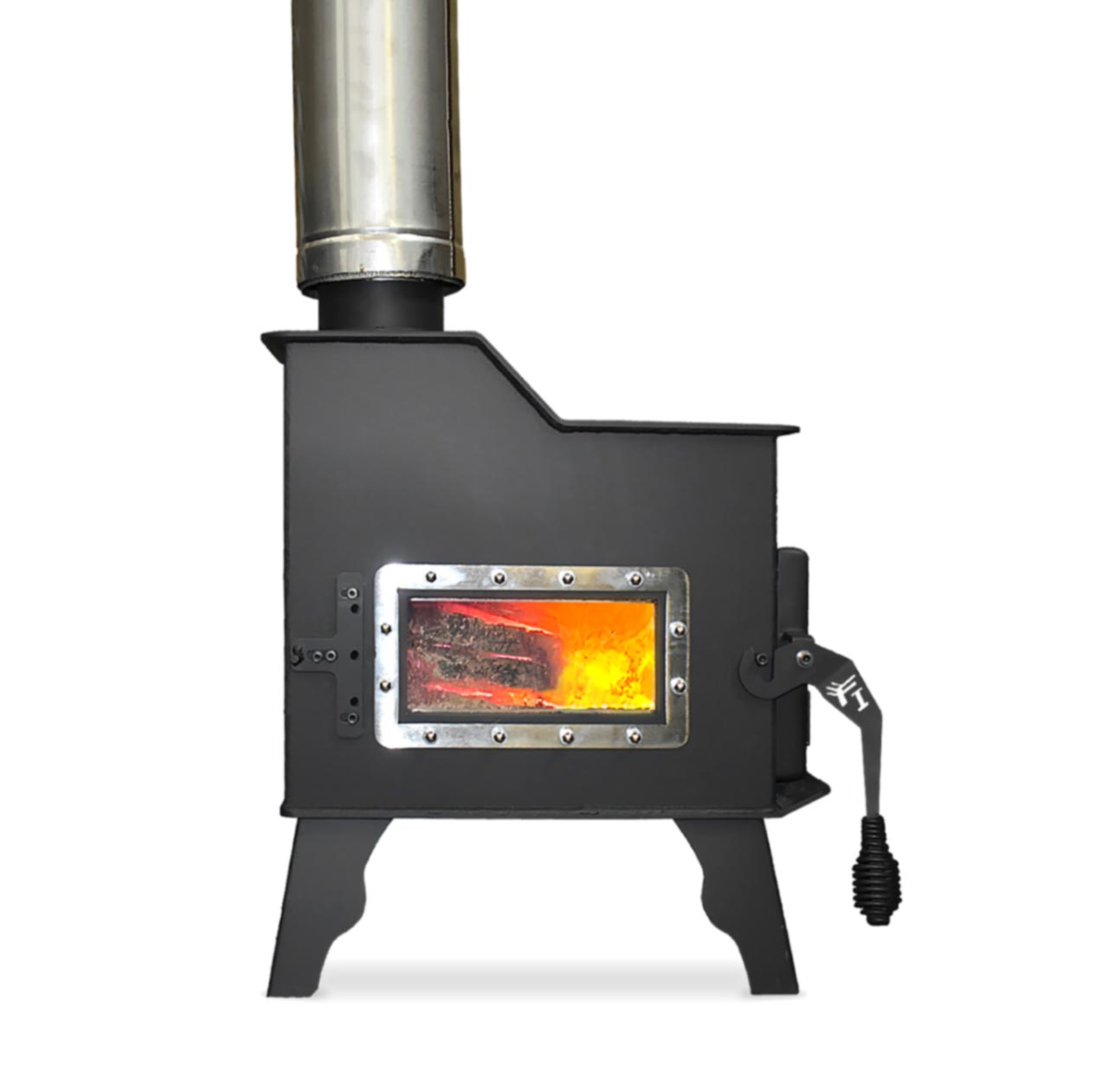

That is a well designed stove from the looks of it. I didn’t see any reference to UL listing or a manual. Wondering if it could pass emissions? The wall mount bracket is wrll
Thought out. 4” HT venting and 14” wood with a bit of a cooktop. Score.
I saw this last year when reading a tiny house article. It is cute. However, some of the claims are wishful thinking. 4-6hr burn time with a .5 cu ft firebox ain't gonna happen. Not even close to that. It's highly radiant and will need lots of protection. The standard clearance is 14" and the hearth requires R=2 insulation protection.
We have a 300 sq foot "flex space" that stays in the 50s from the heat below but not much warmer than that and is used as an office/dog training room. This could be a nice little room heater. I wonder how much chimney it needs to run well.
Since it doesn’t appear to have secondaries or EPA add ons, it probably doesn’t need much.
Given rules like 10-3-2 and stack effect, I’m not sure it’d be easy to shorten the chimney by too much if installed in a regular house. Then again, given the shed sized places this is designed for, and the wall mount, maybe it’s possible to set it up in a way that needs very little pipe. Since it weighs 90lbs, if it’s not too weird of a size a single person could pick it up and put it on its mount. 2 people would make it an easy job.
A low pitched roof with a peak exit… mounted half to three quarters up the wall could give you something like 6’ of pipe. I’ve never loaded a chest height stove, but I can see where that’d be a nice feature for those with back and knee problems .
