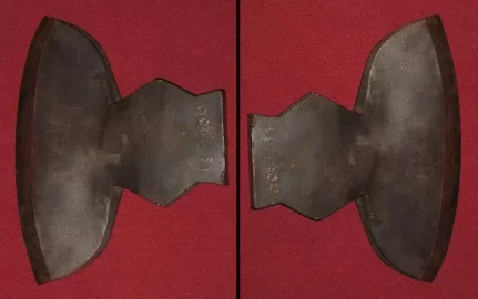

At least on my axe head, the handle can be mounted so the head faces in one of two directions - left or right - as shown in this photo. In either case, the bend will place the handle itself above the head. Which way do right-handers want the edge to face when hewing, left or right?

My broad axe is set up so the handle rises up as the handle proceeds down from the head with the head faced right, like the picture on the right. I make them from Hickory or Ash. Pick the right peice and you won't need to bend. You can bandsaw close to final dimentions, then make octogon by whatever means, and then finsih up.
