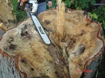

Oh thats bs a very well done tune pipe is between 8-15 percent the high side is new saws trying to meet EPA. My 460 is running a 3/4 inch stainless pipe
here's a pic of it.
