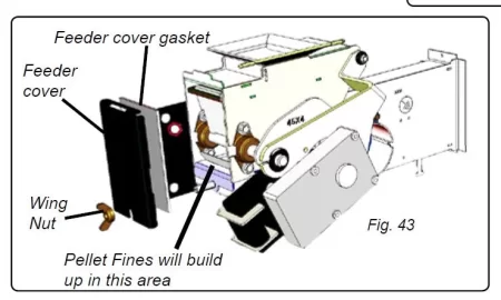

The fines box that most of us refer to is on the right hand side of the stove and is accessed by taking the side and/or rear panel off. It has one large chrome wing nut on it. This will have the fines from unburned pellets contained in it. What you are speaking of is the compartment directly under the burnpot that contains the ignitor. That should be cleaned out every time you clean the stove internally. It has two small wing nuts holding the cover on.

Wasn't sure what the "fines box" might be on an XXV, so I browsed through the manual and found the image below. Page 27 describes cleaning out the fines from the hopper feeder. If there's another area to cleanout fines I couldn't find it in the manual.
  • Harmon XXV fines box
yep, you can get smaller pellets in the fines box, ESPECIALLY when the stove isnt level and leans a bit to that side.....pellets can migrate in that direction due to gravity, and can fit over the slide plate into the fines container....not an issue if you are diligent in cleaning that area every ton or so, but could be an issue if you dont or if your have an extremely out of level stove.
