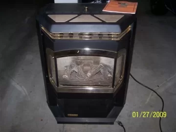

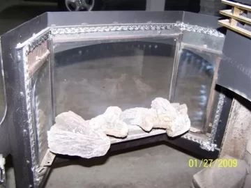

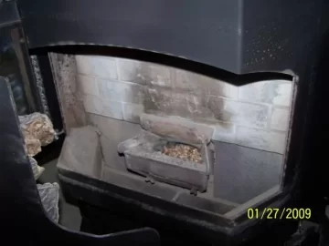

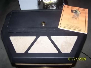

Well I got some pictures to share... not too bad for $450.00

WOW!!!! For $450 you got a steal. Could be my stove that I bought in October for $3500. We're on our 3rd ton of pellets and the stove has been flawless. Lots of heat for 2800 sq ft.. Just be sure you follow the maintenance procedures. I let my stove shut down every 2-3 days. I then clean the glass, scrape the firepot and if I'm ambitoous take a peak at the blower and clean that. After each ton I follow the recommended maintenance procedure. LOTSA LUCK!

You are probably going to want to lose the damn fake logs. I let my wife talk me into buying them and I left them out of the stove after completely cleaning it the last time. They really do not add anything to the way the stove looks or operates and make the 2-3 day cleanings more work then they should be. IMHO they were a waste of $70.
That should be the advance 1
the main differences...
1) cleaning...... Its harder because behind the firebrick panel it doesn't have the 2 access covers to clean the heat exchangers, brush must be run up from the bottom......
hopefully the guy still had it and threw it in, if not a small dryer cleaning brush can be picked up at HD or lowes (the small one about 1 1/2" diameter for cleaning under the lint trap).
2) airwash not as good see the pics in the cleaning pdf attached (yes lose the logs it hinders the airwash even more)
3) metal hopper cover....
cleaning PDF for you.......... (broken link removed to http://www.harmanstoves.com/maintenance/AdvanceCleaningGuide.htm)
I never even noticed the pdf is of the advance 1 not the 2..... :smirk:
I should add while at hd get long screwdriver to help breakup the carbon deposits, in the burnpot......
nice score by the way.....
