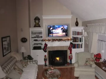

To Lecomte38's point, my unit is installed with the metal housing that Harmon sells that simulates a fireplace enclosure (I don't have a brick fireplace, but once completed, it looks like a fireplace, including the mantle and tile front), and before one can access the plug, the unit has to be slid out on it's rails. I made everything safe by installing a wall switch that feeds the receptacle inside the metal housing. I just shut off the power before removing the insert and everything is safe for insert removal. My reason for boring you with all the housing details is to let you know that when I installed the new ESP probe last Friday, I switched off the power to the stove, and it was off for a good 2 hours plus. My dealer mistakenly gave me a newer, larger probe that Harmon now uses, and I had to go get the correct one from him. Though the plug itself was not removed from the receptacle, the hot feeding the stove was switched off, and I don't think having the neutral still connected would upset the reset process, (would it?). At this point, I am still inclined to lean towards the control panel.
For the benefit of anyone interested, I am attaching a picture of the finished project. Everything you see I made/did myself, including the slide-in bookcases.

That sure is a nice looking and cozy looking room. It looks like you did a real nice job on the book cases as well. Let us know what this turns out to be.
