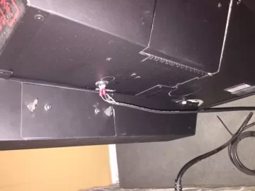

Remove the right, rear access panel - the ESP inserts straight down into the exhaust path probably held in with a self-tapping screw. Unscrew it & gently wiggle it up and out. I gauge how dirty mine is by how much resistance there is to removal & I wipe it down with a wet paper towel.
Either read your manual or download a copy if you don't have one. It will show the location and how to get to to it. Best to have a copy by your side when you clean. Also, it only needs a wipedown. I use a paper towel and Windex. Carefully removing it to clean rather than leaving it in place is, IMO, the best way to do this.
