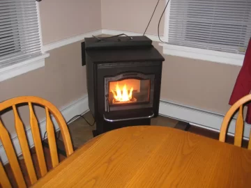

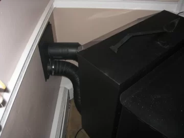

I may be a bit closer to the wall as I have the heat shields on the side.

You also have a corner set up, with a direct vent set up for the exhaust, so you really don't need to account for clearances for the pipe.
Guess that makes the point that I should mention that both my stoves are backed to the wall not kitty-corner. The P61 has a 5' rise inside the house. The P43 has a slight rise (and a funky configuration) before going out of the house
yeah.. your right about corner configs......
