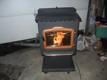

Just found a PP38+ which is a nice little stove that belts out the heat!
However it does not feed pellets for many, many reasons
Has anyone had all these problems?

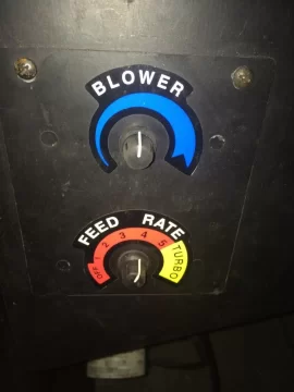

So I pulled out the test cord and checked the feed motor. It turns fine so that is not the problem. The control panel works and there are no dead spots in the 2 potentiometers! Therefore the control panel is good!

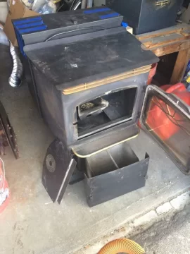

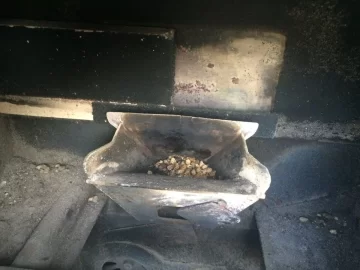

1. Stove was dirty

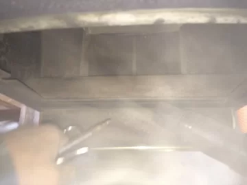

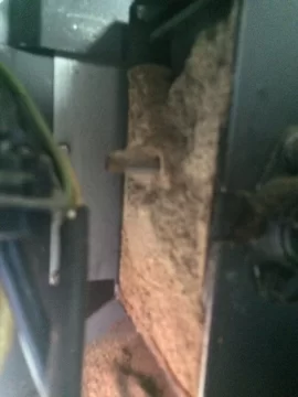

2. Fines Box was full to the brim!

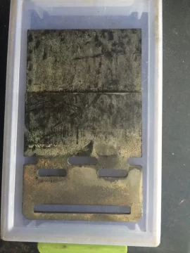

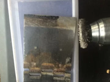

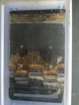

3. The slide plate was stuck from too much pitch at the end

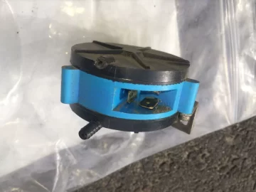

4. Vacuum switch was bad

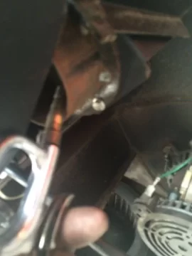

5. The air inlet and air wash pipes were so clogged the new vacuum switch would not work!

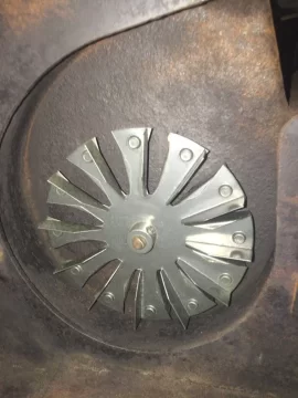

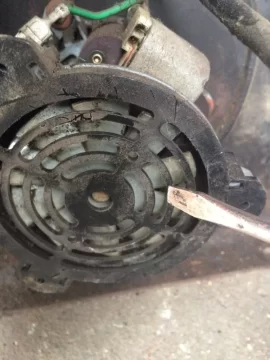

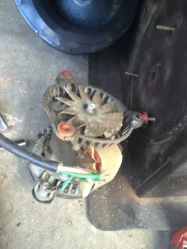

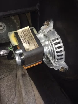

6. The exhaust blower started with a kick from the screw driver but then died! LOL

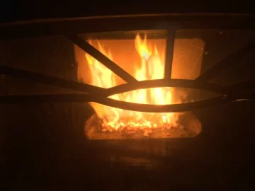

Pic 0 - PP38+ stove
Pic 1 - Control Panel

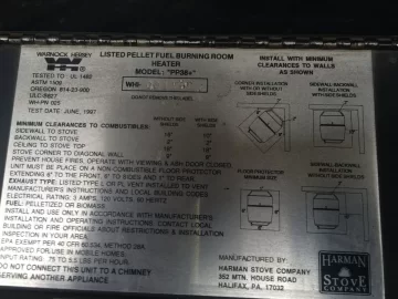

Pic 2 - Full tag

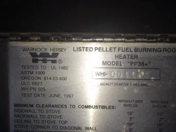

Pic 3 - Model & Serial
Pic 4 - PP38+ - Clean it first!
Pic 5 - Dirty fire box!
Pic 6 - Fines box is loaded!
Pic 7 - Top of slide plate is dirty
Pic 2 - Full tag
