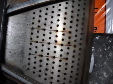

Harman Pb105 Small Crack
Chris, is this the original burnpot that came with your boiler?
Good advice for you Chris. There is a new replacement pot. Ask your dealer for it. Search pB105 for full story.
YEs just bought this year, and its only been up and running for a few months
  • Harman Pb105 Small Crack
Yes, thats the newest design.
I have been pounding the dickens out of my burn pot...running on manual...burned about 4 tons since its been completely off. My last burnpot clean was "on the fly"(still burning...scraped burning pellets into can and scraped completely) looking perfect so far
