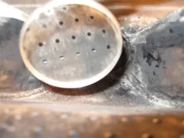

Having a mechanical background I first looked into the location of the ignitor and as I expected the metal shroud surrounding the ignitor was directly below the 1/8" air holes in the burn pot, blocking heat transfir to the pellets.
I removed the ignitor and bent the housing out about 1/8".
Reinstalled the ignitor and the stove has lit on its own within 6 1/2 min. with no ash in the burn pot, from a cold state.
I did this yesterday and have let the stove cool to room temp,cleaned out all the ash, and started under auto mode and have had the same results each time.
I cleaned the ash out because that seemed to be when the auto ignition would most often fail.
The fire started within 6 1/2 min. consistently 4 out of 4 times.
So far 100% success. Before 1 out of 4 tries was the best I could get if I was lucky.
Hopefully this will end this problem.
I have not used the stove when not at home for fear of ignition failure.
I will post if anything changes.
I have attached a picture of the ignitor position as shipped from the factory.
This is viewed using a mirror to see directly through the burn pot air holes.
I hope this helps.
