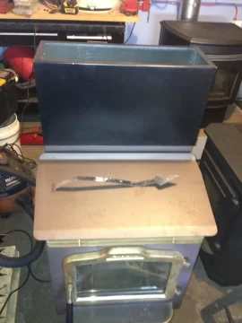

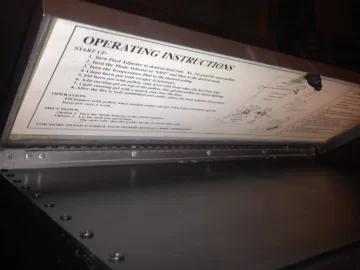

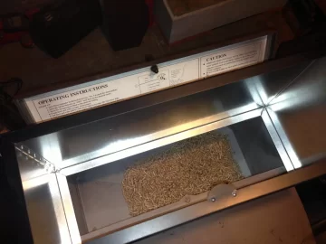

Has anyone done this?
Does not look too hard but if it came with some holes and a few nuts and bolts it would be easier!
No hole for the handle and no holes to bolt it to the existing hopper. The original cover is rivoted!
Could have been made easier to do?
Online Ad specs
Pellet stove hopper extension for 50lbs more pellets 22 3/8wx8dx12h fits p61 or68 using your hopper cover.

I use a few self tappers.
Eric
Nope just set her on top and used a few 1/4" head self tappers. Worked great and the holes were not an issue when the hopper was removed.
