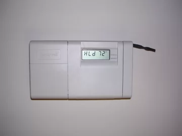

This stoves ability to automatically maintain it's set temp amazes me. I extended the room sensor wire and made a small hole in the wall just above the thermostat for the oil burner. It's the perfect central location.
