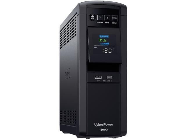

You could use one of these until your generator gets up and running, it is also a power conditioner: https://excessups.com/apc-smart-ups-1500va-980w-usb-serial-120v-sua1500-refurbished
I have used one of these with success too, but purchase it in store so you don't receive a damaged one.
(broken link removed)
The first link is the better choice IMO, you can even get by with the same type in a 1000va (SUA1000) if you don't use the igniter (which you shouldn't do on UPS power anyway). The first one is line interactive, so it should clean your generator power for you. The second one says it will, but I have my doubt's since it seems as if it spends too much time switching.
My stove is plugged into a similar unit:
Gives me plenty of time to get get my 2kw sine wave generator up and running, I then plug the UPS into my generator, stove doesn't miss a beat..I've run it 24 hours, I'd have no issue running it long term. Only things I have plugged into this 2kw generator is the stove , my furnace boiler which has a circuit board, basement lights.. Rest of the house runs off my large 5kw generator..
Reactions: Nitro-Fish
Looks like Costco has sold out of the CybePower CST1500S (same as the one gfreek shows above but with a different button configuration otherwise same specs), so I doubt you'll find one new for the $189 price tag Costco had them for. They can still be had from other retail locations for a bit more money, they may have a different model number depending on the retailer, if I'm not mistaking Best Buy sells them too, just make sure you are getting a pure sine wave unit and not a simulated sine wave unit. As mentioned, this will not allow you to run for hours on end, but it will give you a chance to get the generator up and running. I get it that two generators is a pain, but if your dirty power one is working for you for everything but your stove, a small 1000 watt or 2000 watt inverter type generator will run your stove (1k without using igniter, 2K if you think you want the igniter) and can be had for reasonable money provided you don't need to get a Honda (many lesser known brands are available for about half of the price of a Honda, just read the reviews to see which one you like). I actually purchased a predator 2000 just to run the stove in my workshop with clean power when we are without utility & it works just fine. I don't know if it will outlast my Honda EU3000 for the house stoves, but for the money, I thought I'd give it a try. I do notice all three stoves seem to like the 2 Inverter generator's power better than the whole house unit used for everything else.
