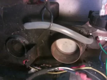

Mine did the same thing. smoke in hopper, flickering flame, installed the feeder air tube and now the stove rocks.
Is there a part number or did you modify as one of the threads I've read bout gummy stove??
I did have the kit ,A length of silicon tubing and 2 connectors. I feel a 1/4 in inner dia tube would do the trick. Two holes were drilled 25/ 64s. One next to the intake flapper and one next to the auger. as in the pic. Insert the tube in the holes and seal with some high temp sealant. The feeder needs the air and the tube does the trick. Stove cranks out the heat now and the only other thing that was changed were the pellets. Power pellets and I don:t think they made the difference. HTHs
was this a Harman problem and this small hose was a tech bulletin sent out . thanks
