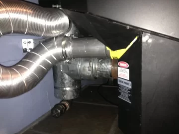

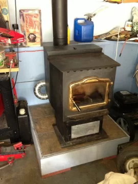

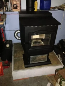

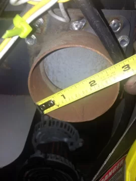

I have been a little frustrated with the Harman OAK flange and trying to get a 3" Selkirk metal flex on it securely and so it can be easily removed! Not quite so simple since the 3" flex does not even fit thru the Harman knock out in the panel because the knock out hole is too small! The harman OAK flange is an odd size with the outside OD almost 2.75 inches!
Since sticking a pipe inside the OAK flange may stop the flapper valve from opening and putting the 3" metal flex over the flange is not only loose but does not fit thru the knock out! ! ! #%$#$%%$#$

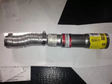

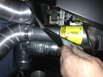

So here is what I just found! This adapter will fit snugly over the flange and is easy to clamp down the 3" metal flex on the 2.5 inch side. The best part is that it fits thru the knock out! ! !
Dynomax Performance 41999 - Walker Exhaust Pipe Adapters and Reducers
http://www.summitracing.com/parts/wlk-41999
Exhaust Pipe Reducer, 2.75 in. ID To 2.5 in. OD, Length 8 in., Aluminized, Each
You can also adapt it down further for 2" flex if needed.![Smile :) :)](/talk/styles/default/xenforo/smileys/grin.gif)
