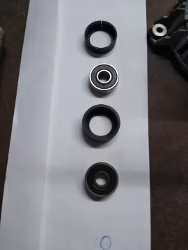

I contacted Gleason Avery, they only sell complete assembly. I need a set of the bearings, but there is a rubber isolator around the outside of each bearing. One of mine is cracked. So I'm kind of hung. I added a photo.

Me, I would carefully super glue that rubber isolator together since not available and try that. I've got a new aftermarket combustion blower just in case..So I can just swap it out with little down time..
