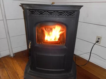

Post photos of your glass/flame. Is this a new stove or old stove. Do you have a pro come and clean it?
Tim here is a pix of stove
You should be more concerned about the lack of a fireproof hearth pad under your stove. It's required by the building codes in my part of the country.
A surge protector to protect the stoves more delicate electronics probably in order too.
He has the factory bolt on base extension,legal.
I see that now. Thanks for pointing that out. It blends in so nicely with the rest of the stove it's unnoticeable.
