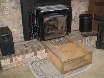

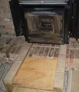

Build something like this. Cut an access hole in the top to get to the fan. 2x4s with flooring tacked to the top to help the stove slide. Hardboard would be better. Used what I had.Hths
  • harman accentra pellet fireplace distribution fan how to clean, fan will not go to high output
If you lay three or four sections of pipe/conduit/stair railing on those 2X4's you can easily roll the insert right out... that's how I helped build the Pyramids (long story)....

Is the fan not working when you put it in test mode? Stove temp mode and room temp mode? Using rollers on the Accentra would only hit the 2 pieces of angle iron on the bottom of the stove that are used to protect the fan. Wouldn't roll out but 6 or 7 " before you would start dragging the rollers. HTHs
