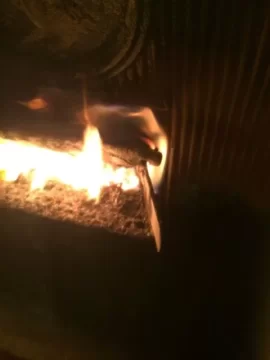

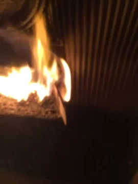

First winter with the stove, got it used came with 2 flame guides, which I thought was strange but appreciated it when finding out I have to chip buildup off them when cleaning. The only part of cleaning I have to go outside for since when chipping the stuff off it flies everywhere.
I've been noticing that I'm getting some weird flame patterns at times and alot of black crusty carbon type stuff between the burn pot and the stove body, which I assume is from this behavior. Happens more when running on higher heat levels, and the flames beside the pot look whispy, main flame is fine. One flame guide seems to be worse than the other, but they both do it.
See pics. Could this be caused by a flame guide needing to be replaced?
They don't appear to be in bad shape
Ive made sure to scape the mating surface on the stove body at the back of the burn pot clean, so the flame guide isnt hung up on anything and its fully seating. Problem goes away after awhile of burning assuming I dont bump the flame guide when scraping, seems the the buildup "seals" it.
