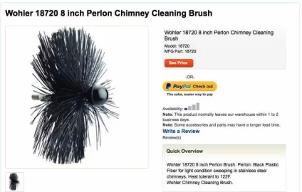

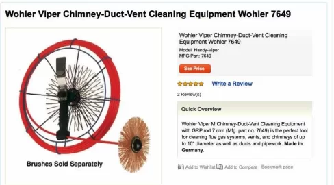

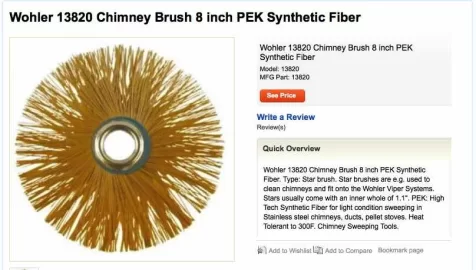

I'm thinking of getting one of these handyvipers which are kind of pricey but it looks like it will help save my bad back during bottom-up cleanouts. There are not many reviews out there on this tool.
Does anybody use it, and if so which brush would work best on a 6" light wall SS Liner?
I was thinking of the PEK star brush but want it to be easy to reverse the brush in the liner.

The handy viper is one of my favourite sweeping methods - I use it or just about all of my zero clearance ss fp flues and ss liners for inserts/stoves/oil boilers. I only use the 12" plastic/poly brush, its the only one i own. When that doesnt work due to third stage creosote build-up (which is rare) i swicth to my fiberglass rods and poly brush sized for flue liner
Thanks for the reply - there is not much information on the Handy Viper at Hearth.com. I'm amazed you can fit a 12" brush in a 6" liner?! I found a decent price ($351) at valuetesters.com and almost pulled the trigger. I gave the sooteater one last chance and figured out a way to make it easier on my bad back. I was not sure if the 8" star brush would work on my 6" ovalized liner ( 7" x 5" or so).
The Viper seems like one of those products someone had a great idea that nobody else copied (that I can find). Wish it were cheaper.

Honestly since we got our rotary cleaning setup I don't even carry my viper on the truck anymore. I find rotary cleaning more effective and easier than the viper. My biggest issue with the viper was the lack of ability to clean the cap from the ground. Rotary cleaners do a good job in most cases. I personally will not buy another viper.

I would think a big enough sized brush on the Viper would clean the cap from the ground and the great thing about the Viper (I thought) was that you only carry one spool instead of fussing with all those individual rods that you have to join and then separate. Seems like it would be so much quicker.

If you could spin it in the cap yes but you cannot with the viper. Using the viper I had to go up and clean the cam much more often than I do with our rotary. I also find the viper a little awkward to use I find botton lock rotary rods much easier and faster. But that is just my personal taste I know others feel differently.
I the viper comfortable to use but must use left handed with the rod coming out of the spool on the bottom. I go to the top on every job (while my guy sweeps) to check out exterior chimney as well as clean cap and check flue/other flues. I must admit ive never tried rotary but ive heard only great things about it and want to get into it.

I do not think the star brush would work in your oval liner.

I had a feeling the star brush would not work on the oval liner. Sounds like it's good I stuck w/ the sooteater but I'd like to see a Viper in action some day.
I'm curious what makes the Viper awkward to use? I thought the idea was you snake it up the liner while brushing back and forth and then reel it in? Seems easier than fiddling with lots of rods that have to be assembled and disassembled each time.
I'm curious what makes the Viper awkward to use? I thought the idea was you snake it up the liner iwhile brushing back and forth and then reel it in? Seems easier than fiddling with lots of rods that have to be assembled and disassembled each time.
if there is much resistance you have to keep fiddling with it to keep it going up you have to brush up and down multiple times and you cant get the cap clean. I can clean betterd with a rotary cleaner in half the time and the cap gets clean as well. I am not saying the viper is a bad product I just prefer my rotary cleaner I know it keeps me off of more roofs and out of harms way much more than the viper did. And my rotary rods don't take any fiddling I use 3 foot rods which I find much easier than the 5 footers. And the button locks on mine work very easily.
Now I understand. I can picture how the relatively flimsy Viper rod might require more "fiddling" to keep it moving.
I wish the Sooteater had those great button locks but they are not too bad - the trick is to reverse the drill to unwind the rod torque and I made a tool that makes them easier to release.
